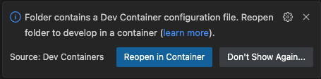

Open the repository in GitHub Codespaces or VSCode. If you are using VSCode, a dialog (depicted below) should pop up asking if you want to open the repository in a development container – click Reopen in Container.
../_images/open-in-container.png
Thats all for the environment! With the magic of Docker, all dependencies will now be installed and won’t clutter your main operating system.
